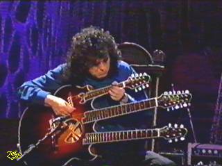

Mark,
i m talking a full on acoustic thing.
kindda like this:
should be challenging and interesting
Udi.
PostPosted: Thu Mar 23, 2006 4:39 am
Posts: 575
Ahh, that is cool. A flat-top, with a pinned bridge. Is that one built by Andy Manson? It's very good.
I prefer to use floating bridges and a tailpiece. I can see how that may not work well for a triple-neck kind of instrument, but that's what I am going to use.

I make flat top mandolins. Some things that I think are important is to use an X brace. Most FT mandos are ladder braced. I also put a 15' radius into the top. This allow for the bridge to be taller and gives the strings a bit more down pressure. Also the neck can lay flat on the soundboard without having a wedge or a cantaliever. The X brace was chosen to maintain the 15' arch. Make the sound hole smaller than you think you should be just a bit.
I've never made a pin bridge mando so I can't comment on how that would turn out. I try to find a way to isolate the mandolin part of the sound board from the other part. A big fat brace seperating them should do the trick.

Mark,
yep, thats the one built by mason indeed.
its pretty cool i think, even though not the most practical musical instrument...and i guess theres a reason why Jimmy Page only used the mando, and none of the other two necks.
but figured itll be cool having this thing hanging on the wall in my room.
